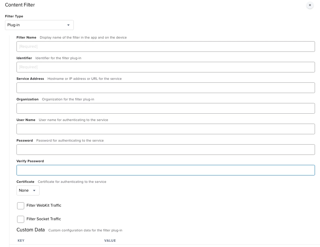

So I did a little digging, and you weren't kidding about sparse documentation for this thing. I was able to get the gist of what it is supposed to do, and from what I could gather it looks like the payload for this app needs to be configured as a Content Filter configuration.
When you create the iOS profile, you can add the Content Filter payload type, and change the filter type to plugin. It will need at least the display name and bundle ID of the filter, and also the kind of filter. It looks like you would want to configure it as a WebKit traffic filter, based on the snippet of the config you shared above. Any keys outside of the fields Jamf gives you can be added in the custom data section at the bottom. In many cases the username/password/service address aren't required, since the accompanying application handles the authentication aspect with the management server (Symantec Endpoint Protection and Carbon Black EDR are like this).

When you edit a configuration profile, there is a section in Applications & Custom Settings > Upload where you can paste the entire plist of your configuration. I'm fairly certain that this requires a full plist, complete with XML and plist headers. Also, what app's config are you looking to push?
@jcaleshireMany thanks for this, and sorry for the late reply to this. I didn't know I could add it as a content filter configuration, so I'll look into this.

We got this working, wohoo. Thanks for the help @jcaleshire, we're providing Netclean with some screenshots and information on how to set this up working in Jamf now so that it will be easier for other customers.
