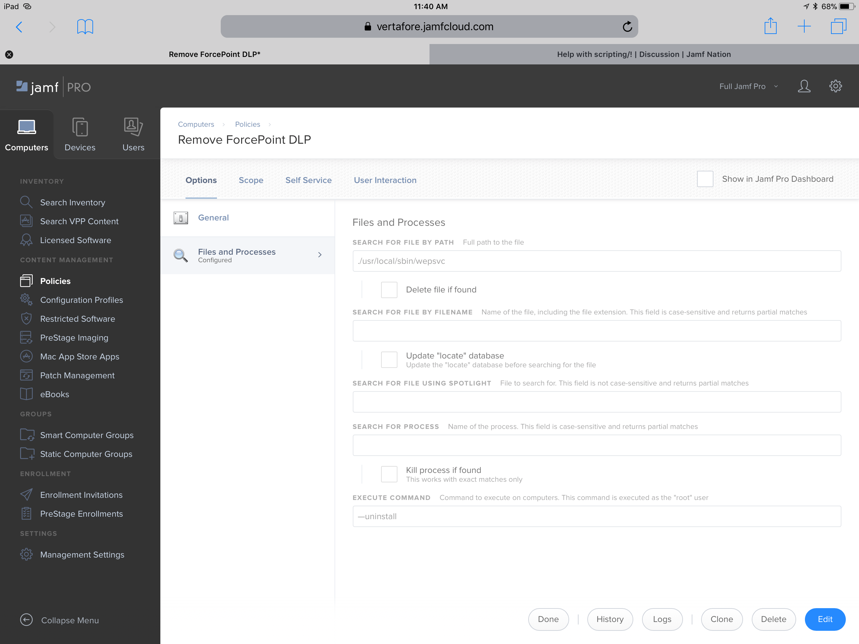

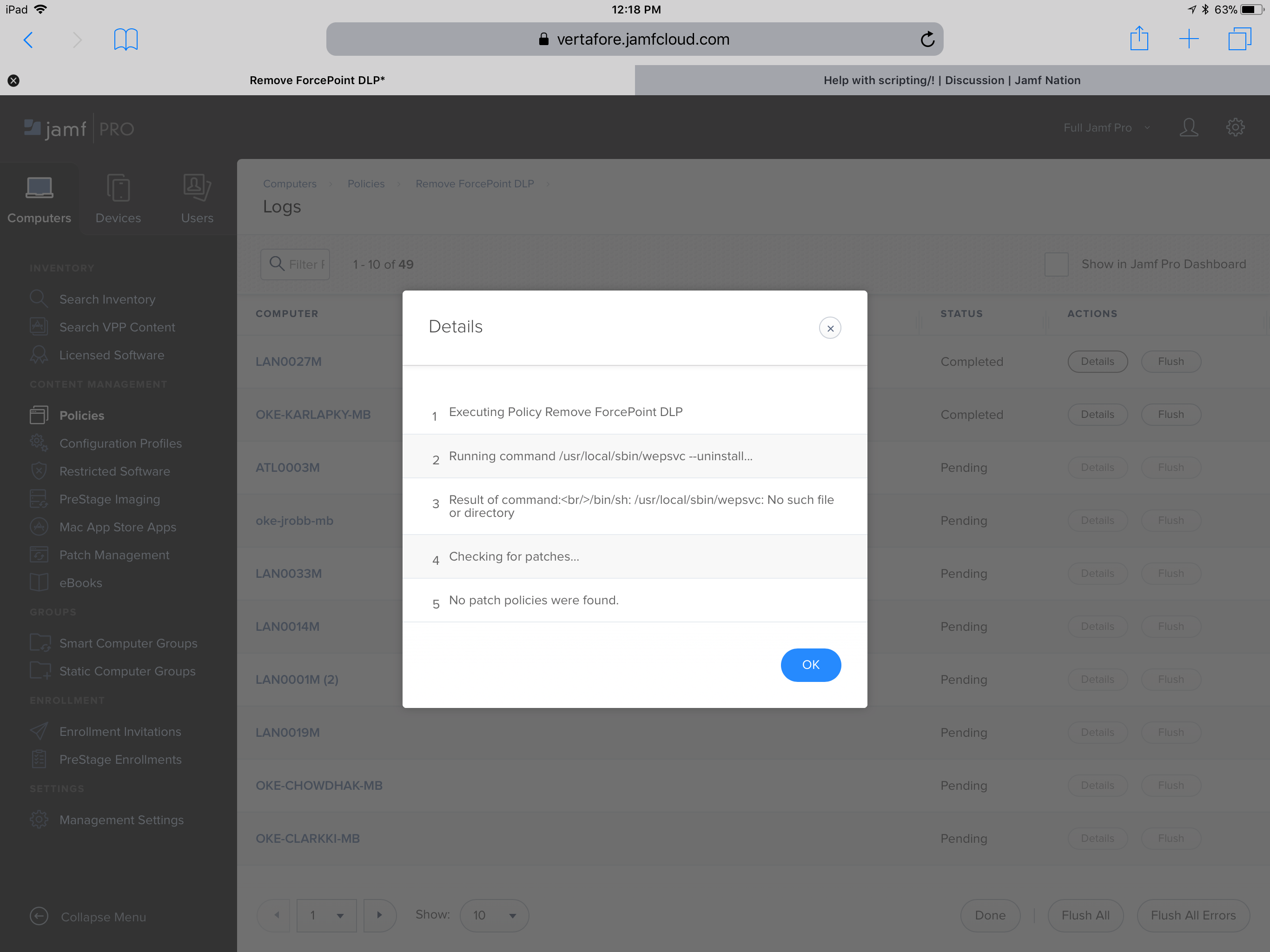

If I do that, I get this;
  • 142 replies
  • January 31, 2018
Just an observation
in your previous screen grab you put a path in the field to search for was that intentional?
It appears your uninstall command is running the uninstall and then the policy is searching for the path.

OK, so it's at this point that I would ask you verify the websvc binary is actually in the /usr/local/sbin/ location. Is it possible you're asking it to run something that isn't on the target machine? It sounds like it just can't locate that binary to me.
Tangentism
  • 147 replies
  • February 2, 2018
You can go to terminal and type:
which websvc
and it will give you a path
