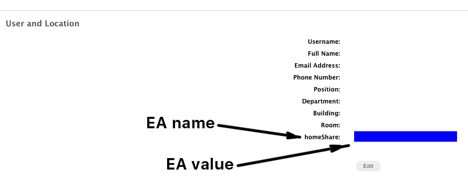

Yes. I am looking for how to make variable var getting the value of EA.
homeShare is the name of EA which gets info from LDAP. It works, shows in inventory screen correct value.
