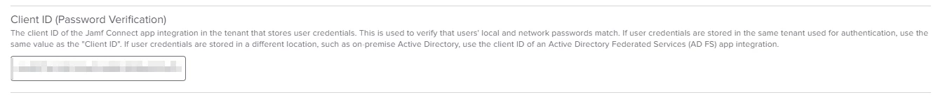

Update:
In my case, we are using a hybrid environment and I needed to fill in the Identity Provider (Hybrid ID) details.
Configuring Jamf Connect Login with Microsoft Azure AD - Jamf Connect Administrator's Guide | Jamf
The Hybrid Identity part.

Additionally:
com.jamf.connect.login
We have a hybrid environment, could it be that I am using the wrong Client ID here?
