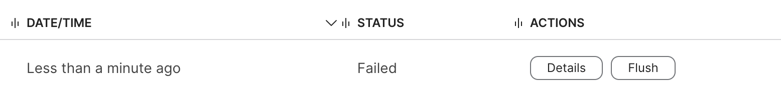

First screenshot is the output from VScode

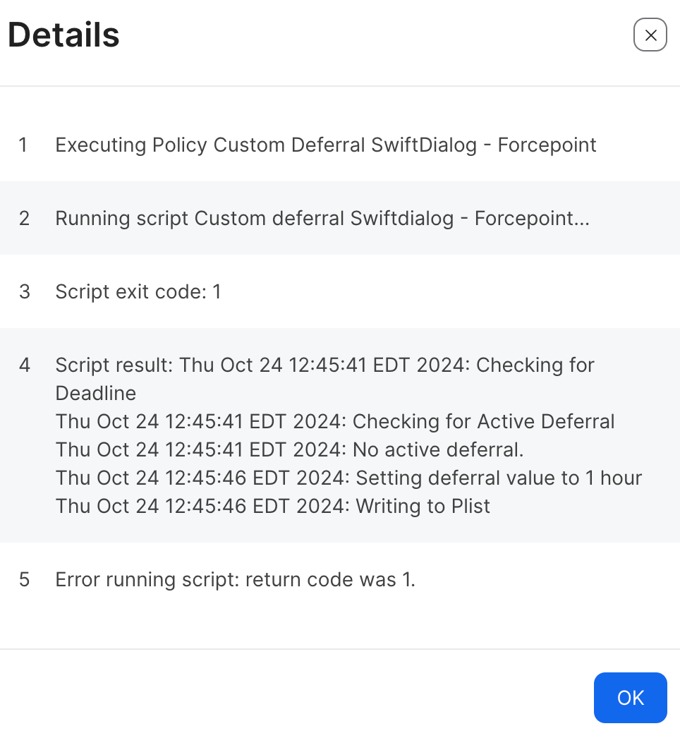

Second and third are from Jamf
I use the exact same code in VScode and JAMF , the script does everything as intended. But i see the exit status as failed in jamf and with error code 1.
Can anyone advise why is this happening and i get failed exit status in Jamf even tho the script work as intended?

Your Write_To_Config function is simply causing the exit code 1 because of the line
cleanup_and_exit 1 "Set deferral, Exiting."
So you'll need to decide when do you need to exit with an error and when do you not, and adjust your use of cleanup_and_exit.
