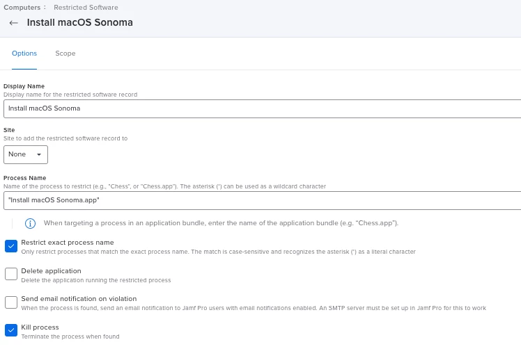

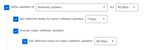

Is anyone else seeing macOS Sonoma not respecting the delay within the restrictions payload?
I have the delay for Major software updates set to 90 days. In addition I also have a software restriction setup for "Install macOS Sonoma.app". Not sure how my users / systems are being updated?

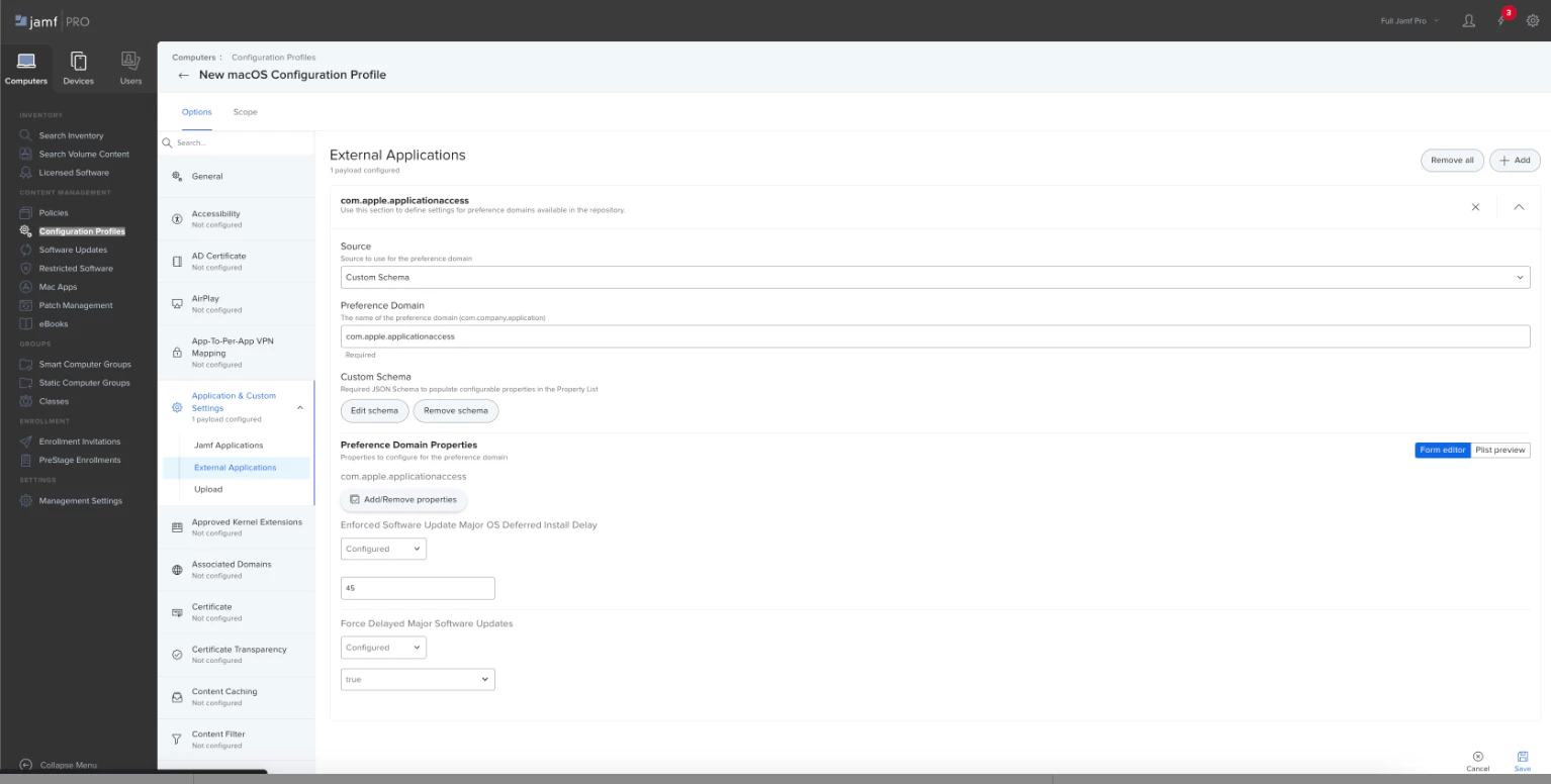

Introduction
This article provides steps to restrict macOS Sonoma from being installed via System Settings/System Preferences on computers managed by Jamf Pro using a Custom JSON Schema deployed with a Jamf Pro configuration profile.
While the Restrictions payload in a Jamf Pro configuration profile can be used to defer macOS Sonoma as outlined in the Technical Paper Deferring Availability of macOS Software Upgrades and Updates with a Configuration Profile, the Custom JSON Schema is a good option if:
  • you don't want to deploy the Restrictions payload in Jamf Pro
  • you have an existing configuration profile with Restrictions enabled that you don't want to update and re-deploy
Instructions
1. In Jamf Pro, navigate to Computers > Configuration Profiles and click New.
2. Fill out the Display Name in the General payload.
3. Select the Application & Custom Settings payload, click External Applications, and click the +Add button in the upper-right corner.
4. For Source, choose Custom Schema from the dropdown box. In the Preference Domain field paste use the domain: com.apple.applicationaccess

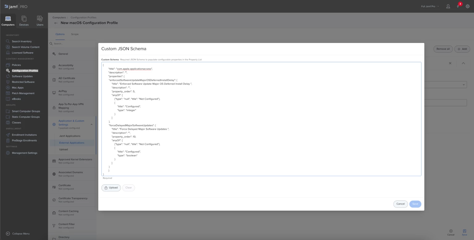

5. Click +Add schema, paste the text below in the Custom Schema box, and click Save.
	"title": "com.apple.applicationaccess",
	"description": "",
	"properties": {
        "enforcedSoftwareUpdateMajorOSDeferredInstallDelay": {
            "title": "Enforced Software Update Major OS Deferred Install Delay ",
            "description": "",
            "property_order": 5,
            "anyOf": [
                {"type": "null", "title": "Not Configured"},
                    "title": "Configured",
                    "type": "integer"
        "forceDelayedMajorSoftwareUpdates": {
            "title": "Force Delayed Major Software Updates ",
            "description": "",
            "property_order": 10,
            "anyOf": [
                    "type": "boolean"
6. Additional fields to be completed will populate:
a. Enforced Software Update Major OS Deferred Install Delay: Use the dropdown to select Configured, and in the additional box that appears set the value (1-90) for the number of days to restrict the update.
b. Force Delayed Major Software Updates: Use the dropdown to select Configured, and set the additional box to True.
7. Click Scope and add a test computer or test computer group to ensure the update is blocked.
8. Click Save.
