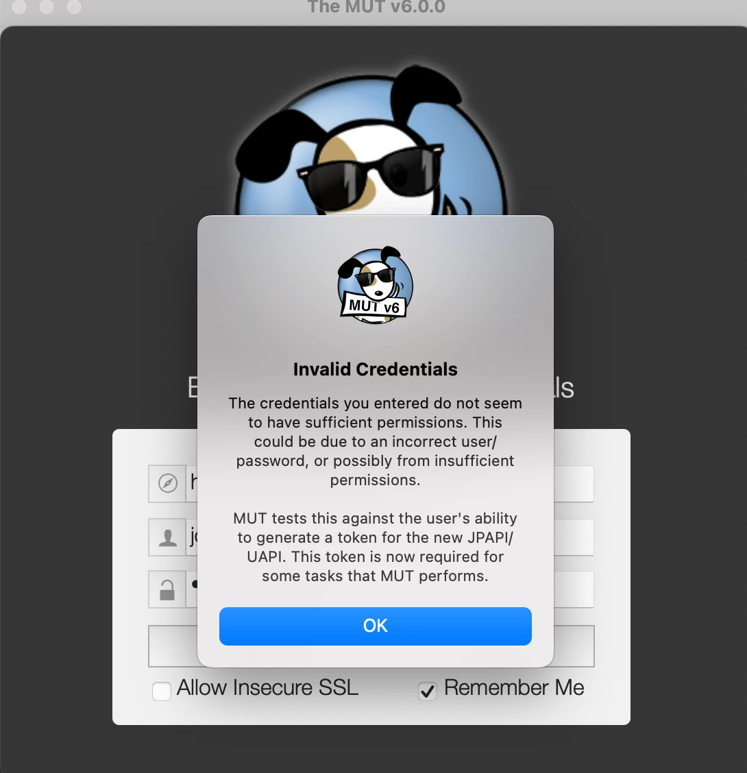

I'm having trouble logging in to Mut with my SSO. I get this error message, but I know my Jamf credentials are working because I use them every time I log into Jamf. Do I need to make some changes or have request access?
I've tried using this link but still having issues.

I dont use MUT myself, but if I remember correctly its all API. I dont think you can authenticate API with SSO credentials. The user account needs to be listed in JAMF users and Groups with whatever permissions specified.
  • May 4, 2023 12:36 AM UTC
Yeah, I had to create a user account in Jamf in order to log in with Mut. Thanks for the update.

I had an auth issue after the 11.5 update.  I updated MUT to 6.2.1 (and I was able to login successfully.
                                v6.2.1 - Authentication updates Latest May 14, 2024

We have users added in Jamf as Directory Service Users (we use Google LDAP). They SAML in with an IdP that is not Google. MUT logins seem to still be working fine for us on 6.2.1 with the directory accounts.
Update: Well, we can login but it doesn't appear to work anymore. Which I guess makes sense with username / password API auth changing to client ID / secret.
Error in regular mode, classic mode says it succeeds but it doesn't actually do anything.
Logs show 401 errors (authentication error) which I guess is expected.
Maybe the app needs to be updated for client ID / secret instead of username + password?
