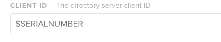

we bind using the Serial Number
Then I have a policy that renames the HostName, LocalHostName, and ComputerName to its Asset Tag.

So we use the prestage to to set the serial number to UK-$ serial number or what ever prefix then we run the following script to update the host name which works really good for us as we use site locations as our main prefix.
!/bin/bash
ADCOMPUTERNAME=dsconfigad -show | grep "Computer Account" | awk '{print $4}' | cut -d '$' -f 1
if [ "$ADCOMPUTERNAME" == "" ]; then
echo "Unable to determine computer name";
exit 1;
echo "Setting computer name to: $ADCOMPUTERNAME";
/usr/local/bin/jamf setComputerName -name $ADCOMPUTERNAME
exit 0;
@uoscasper machine naming with DEP notify does not work that well if you bind your mac to the domain so i have it at prestage then a script in depnotify to update the host name
