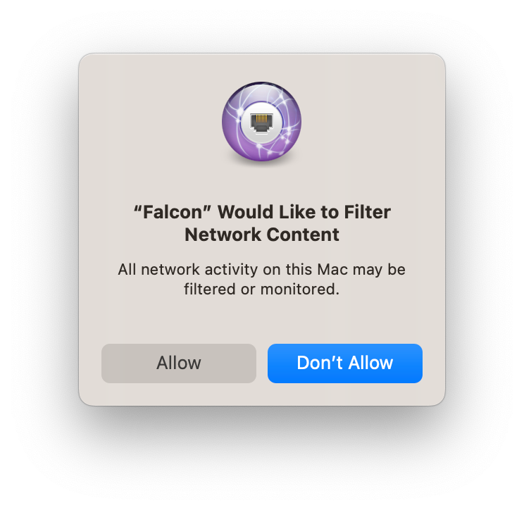

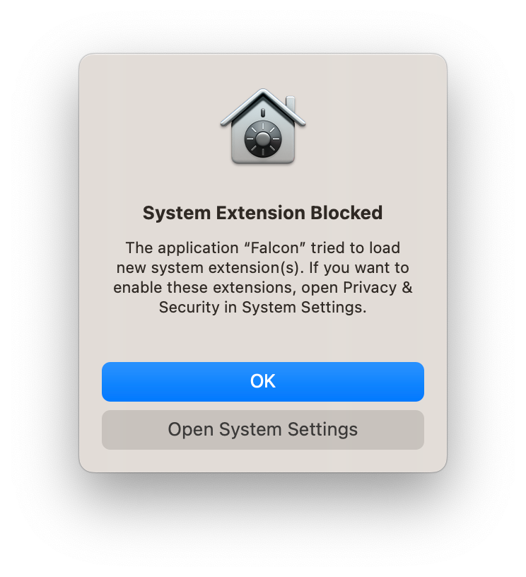

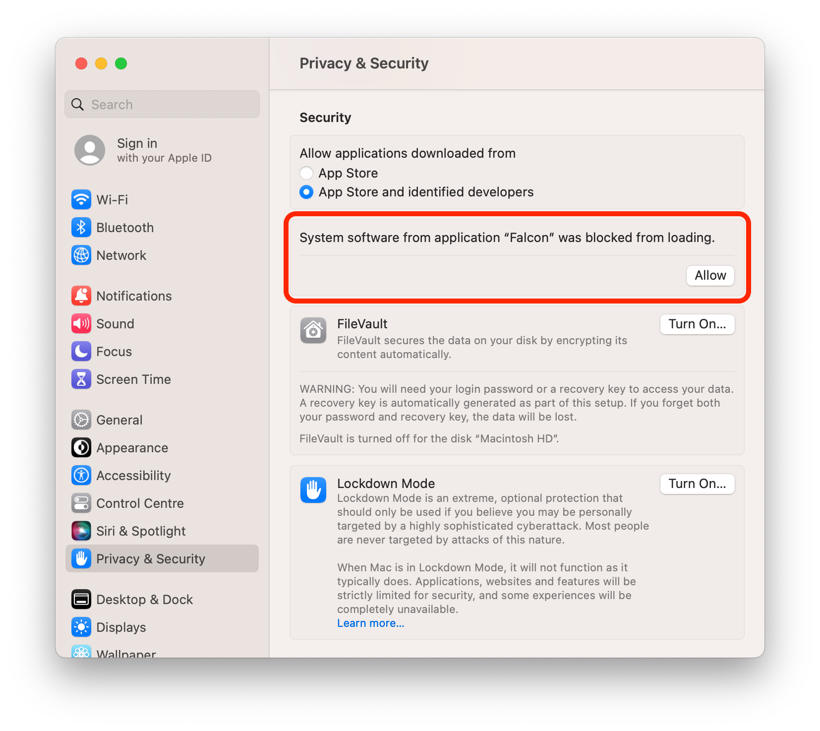

Hi, I have written a script to install CS falcon on Mac via JAMF, but script successfully install the CS falcon on Mac system but "Falcon” Would Like to Filter Network Content" in network extension and "The System Extension Blocked message" in Security & Privacy, which need to "Allow" manually.
Need help to correct the script for automatically run the process without user interaction, following script.

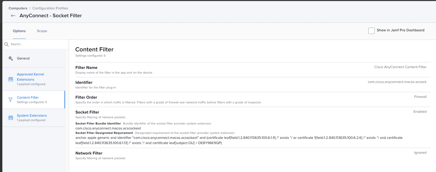

As @mm2270 said, you need a Content Filter Configuration Profile. Its pretty simple to make, but you need some basic information about the App. I would recommend reaching out to the vendor. They should have a mobileconfig you can upload in to JAMF which does what you need, if not in the very least they should have the information you need to make the configuration profile.
This is what AnyConnects would look like for context.
