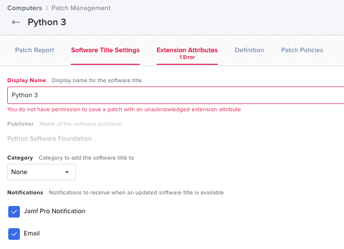

Hello,

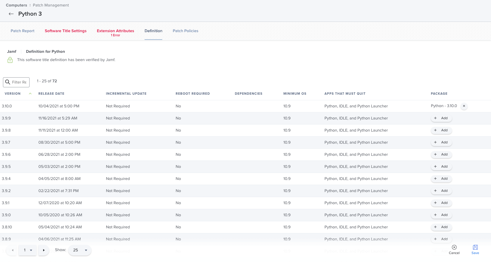

I'm fairly new to Jamf Pro and there is still A LOT to learn, but I seem to be getting an error that I cannot resolve when adding the .pkg definition for Python version 3.10.0:
"You do not have permission to save a patch with an unacknowledged extension attribute"
However, I'm unable to change any extension attribute from the "Extension Attributes" tab as it seems they have resolved here.
This problem is directly keeping us from deploying the software policy and therefore updates via Jamf Pro are on hold.
Please see attached screen snips in regards to this problem.

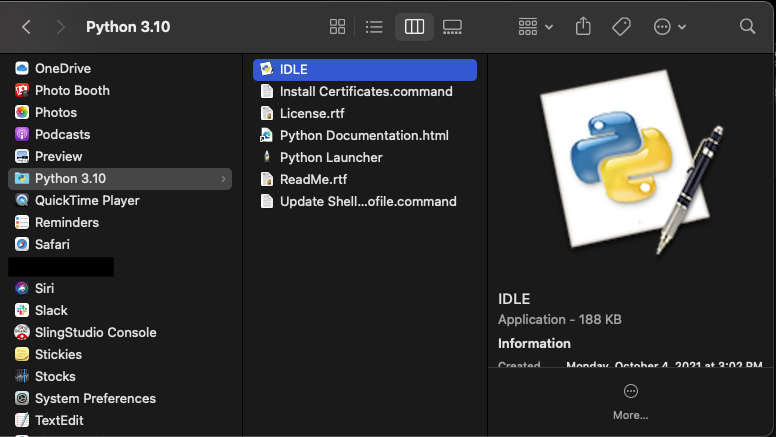

FYI, the .pkg installer does come with two .apps; "IDLE" and "Python Launcher" which i'm not used to seeing before (not saying much); So maybe it has something to do with this (?).
Maybe i'm just overlooking something simple, but I just cannot see it at this point in time.

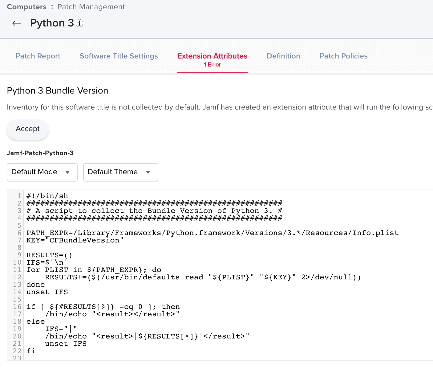

Best answer by mm2270
@M_Rivero Have you clicked the Edit button when in the Python 3 Patch title definition and then clicked on the Extension Attribute tab? There should be a button when you do that that says "Accept" like shown below.
The "Accept" button won't show up when just viewing the patch title. You have to be in Edit mode to see it. If you're able to see that, click Accept and then acknowledge the prompt that appears by placing a check in the box, then finally click Save back on the edit screen. The Extension Attribute error should disappear.
Good luck, and post back if you still don't see that.

Thank you @ljcacioppo, this comment was what spawned the investigation. @mm2270 had the screenshot as well which ultimately showed the difference: I don't have create privileges for extension attributes. Thank you both!
