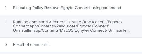

Hi @sdagley , thanks for your post! I've learned something new here already. I wasn't aware of the Files & Processes ability to run a command, so thanks! I set that up and although it ran the command, the application wasn't removed and there was no result recorded.
Have I set it up incorrectly?

@sparrowhawk Can you try running the command from Terminal on a Mac with the software installed and see if that works? (you'll need to include the sudo for that) And if it doesn't is there any additional information reported when you run the uninstaller that way?

I've already tested that and it works when run locally.

If I had to guess, this command probably only works in a user context, since it's an executable from the app bundle. It probably launches an app that needs to be responded to to complete the uninstallation. Some other apps work this way too, like the uninstaller for Cisco AnyConnect.
Is that the case when you run it locally on a device instead of from a Jamf Pro policy?

Hi @sdagley  and @mm2270, I've been on leave for a few days. The command runs silently and doesn't require any user interaction.

Hi @Deku91, you've cracked it! I just had to add a pkill "Egnyte Connect" as the application can't be running and setting the script to launch at login wasn't quick enough. The notifications didn't pop up, but I'm not worried about those.
