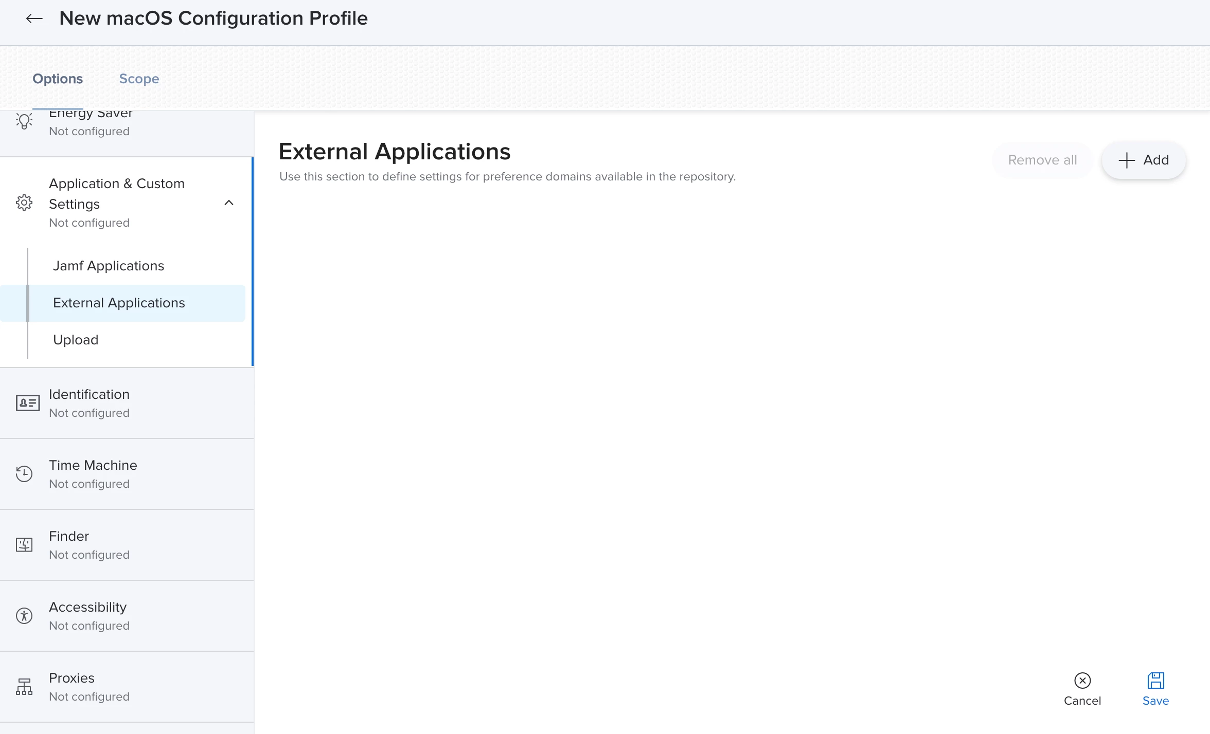

  • Aug 24, 2022 6:57 PM UTC
Hello I am relatively new to Mac administration. I come from a Windows background. I am trying to push the Safari 15.6.1 security update release Aug 18 2022. What would be the most efficient way? I've already downloaded SUS inspector and downloaded the pkg. Would it be through a configuration profile? What would be the application settings?  Jamf, external, upload? Thank you in advance.
sdagley
  • Aug 24, 2022 7:07 PM UTC
@fireant A Configuration Profile isn't what you'd want to deploy an application. To deploy the Safari 15.6.1 .pkg you'd need to uploaded it to your Jamf Pro Distribution Point (be that a local DP of a Jamf Cloud DP). Then you'd create a Policy to deploy the .pkg to Macs using a Smart Group to target machines that aren't current, or if you're a Jamf Cloud customer you could use a watch Management configuration for Apple Safari and create a Patch Policy for 15.61 to push that .pkg to Macs not yet at that version.
  • Aug 24, 2022 7:16 PM UTC
Thank you @sdagley So a policy would be the best practice to update Safari. If I also wanted to update existing Monterey machines to the new security patch 12.5.1 released by Apple on Aug 17th would a policy also be best practice? Thank you so very much for your prompt and thorough response!
