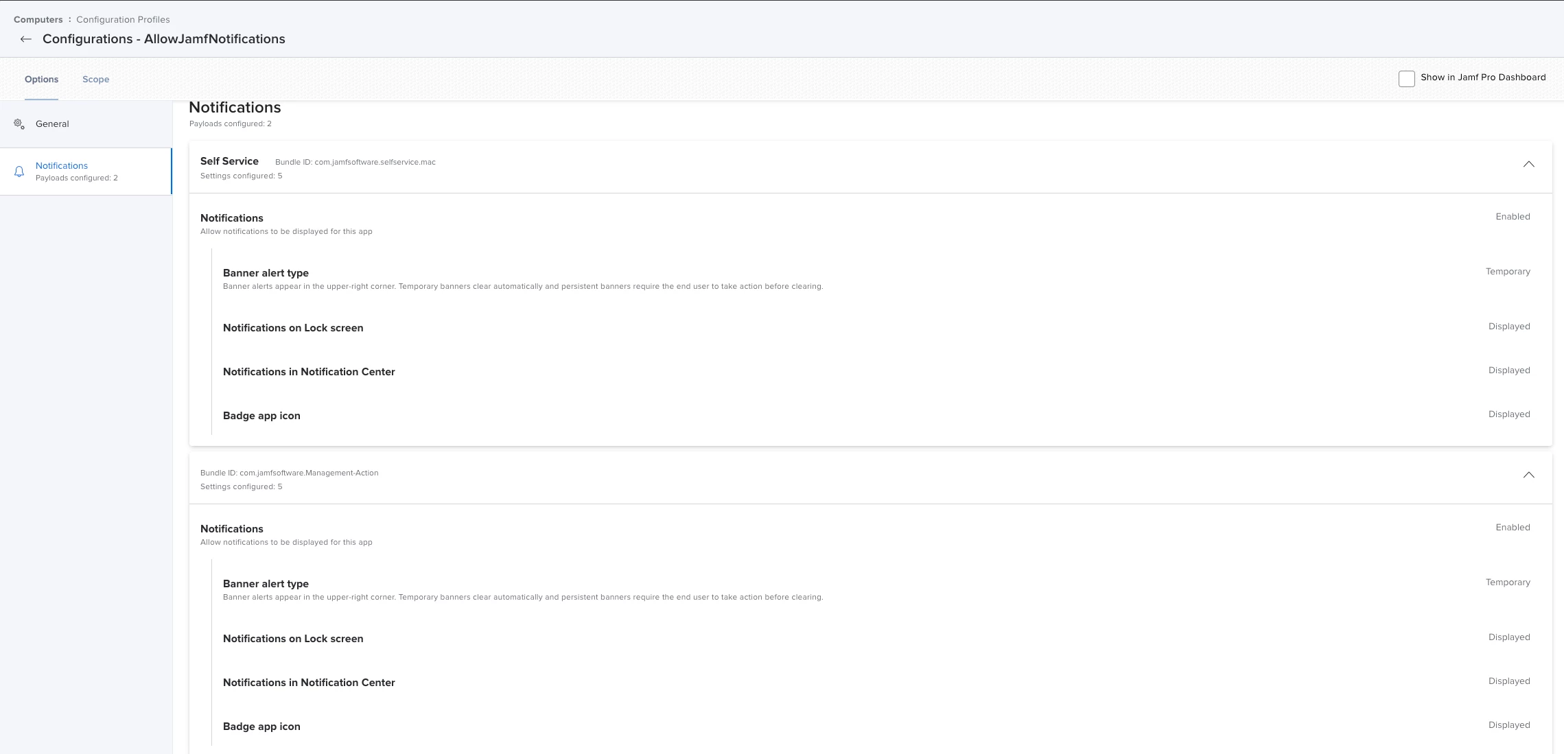

Hi
We push our software updates through self service for a few days before installing automatically on user's machines. We are trying to set it up so that the end users get a notification (either push notification or on the self service icon itself) but are running into issues. We don't get any notifications from self service unless self service is open; and even then it's not a push notification but an indicator on the app icon.
We have our push certificates up to date and we have a configuration profile that allows for Jamf notifications. Are we missing anything else here?

That would make sense definitely voted on that one. Yeah we have some other notifications setup but they are pretty intrusive; appreciate the response!
