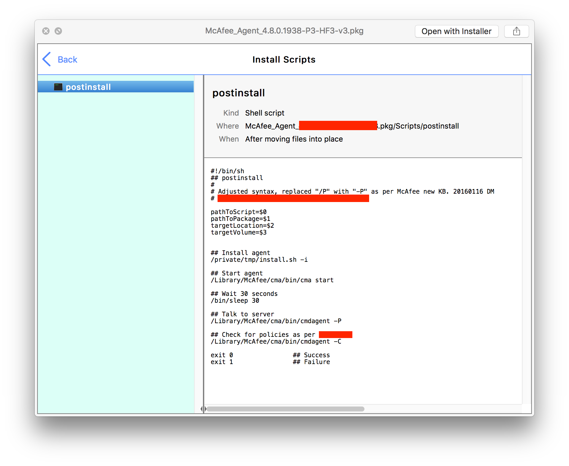

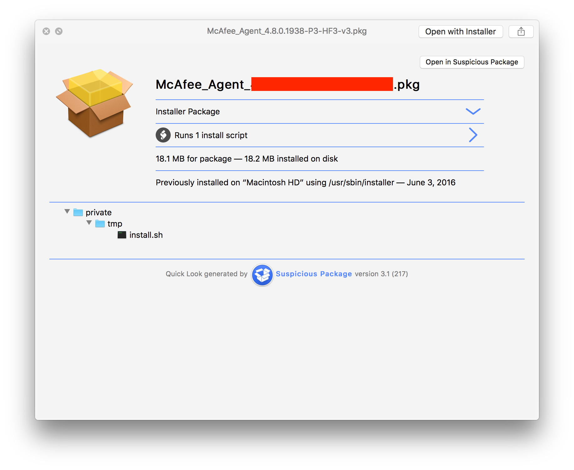

You'll need to wrap install.sh and put it somewhere like /tmp, then use a postinstallation script to invoke the install. Check out the attached screenshots.
