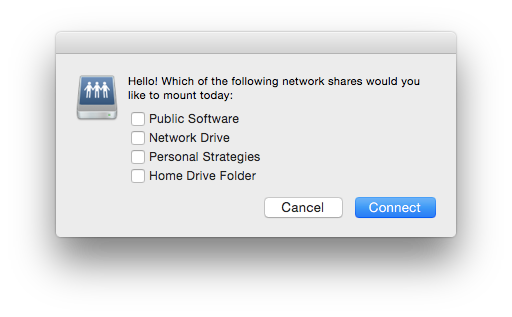

@Hafiz Would something that pops up a dialog like the following work for your users? So they can just check the items they want mounted?

Hi @Hafiz Ok, I have some time now to write this up. Here is a little tutorial on how to build an app with Platypus that uses cocoaDialog for parts or all of the UI.
First thing I wanted to post was the script I generated that will do the actual work. This is what created the dialog image I show above.

## Create a cocoaDialog checkbox dialog asking the user to select from a list of shares to mount
RequestDialog=$("$cdPath" checkbox
    --title ""
    --items "${ShareNames[@]}"
    --label "Hello! Which of the following network shares would you like to mount today:"
    --button1 "Connect"
    --button2 " Cancel "
    --cancel "button2"
    --width 400
    --icon-file "$networkIcon"
    --value-required
    --empty-text "Please check at least one item before clicking Connect. Or click Cancel to exit."
    --quiet)

If you go down to Start of Script, I have a variable I'm creating using a cocoaDialog call. The dialog uses the checkbox style. I'm passing the ShareNames array to the --items flag, which sets each share name as its own checkbox. There's some dialog text, 2 buttons, one designated as the 'cancel' button, a width setting and the network icon.
The last 3 items in the cocoaDialog call are important to understand. The --value-required flag tells cocoaDialog not to exit with the default button ("Connect" in this case), when asking for user input (checkboxes, radio buttons, text fields, etc) The user must do something or select something before they can click the "Connect" button. If they don't, they get the text that shows up after the --empty-text flag.
The --cancel flag we set earlier allows them to click Cancel to exit the script if they want.
Last is the --quiet flag. This suppresses the button clicked callback. Normally we'd see a "1" or "2" depending on the button clicked. Since we're forcing either a selection or a cancel from the user, we only need to check to see if the variable got filled with some result. If it comes back null, then they canceled.

@mm2270 Thank you so much! I am sure others will find this useful too. I will try this out next week and let you know how I get on. Cheers!
