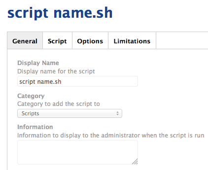

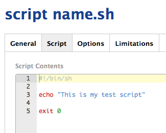

I can see some value in being able to create new script objects in the JSS via the API. Its somewhat limited but it may be valuable in certain use cases.
I just threw something together very quickly after pulling down one of our simple scripts from our JSS to examine how they appear in the API. The test I ran with this worked and created a new script called "script name.sh under our category of "Scripts" with an ID of 241 (previously 240 was the highest ID)
jssURL="https://jss.company.com/JSSResource/scripts"

The script then shows up in my JSS when I refresh the scripts page:
Hope that helps. Edit: Whoops. Forgot the script tags.
