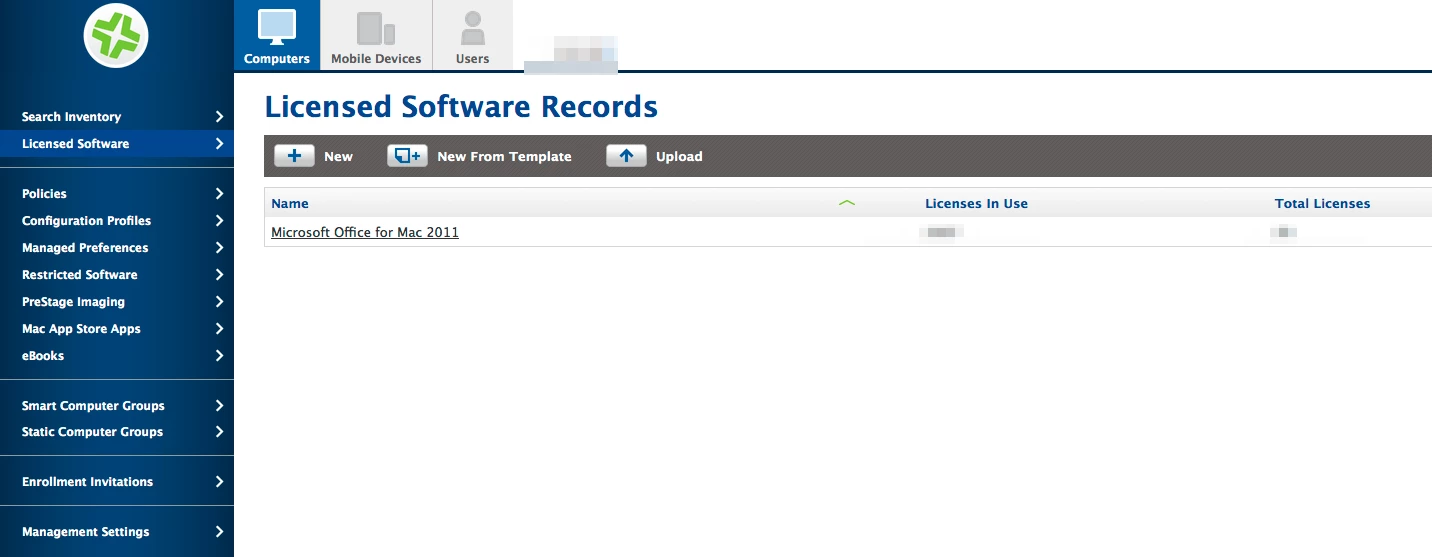

I have an app that we have X licenses for. I don't install it by default, but do want to make sure we stay within our licensed limit. I assumed this would be fairly easy to setup using a smart group that, but there doesn't appear to be any way to get the "Licenses in Use" as a criteria. If I could use that, it would seem like I could keep licenses in check fairly easily…
Am I missing something? Does anyone do something like this using another method?

Does that help?

You want to use the Licensed Software feature of the JSS for this. You configure the app name and version, how many licenses you have and whether to ignore App Store versions of the app, in case your environment is mixed. Then you can configure the JSS to show the licensed software on the JSS dashboard and/or to email you on violations. What's neat is if you gather application usage, you can also see how much the licensed software is or isn't being used on specific computers.
(Page 415 of the Administrator's Guide)
