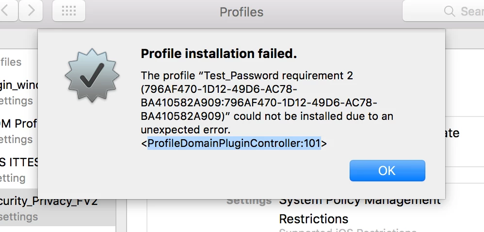

I also downloaded this profile and tried to install it manually. but it shows an error like attached

We are having the same issue here with the same error message.
So far and profile deployed from the JSS with the Passcode payload enabled will fail on 10.11.1. Even trying to deploy the payload from a OSX server is failing for me...

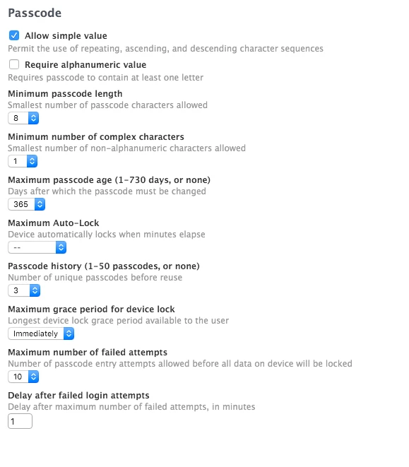

I finally got the Passcode policy to apply to 10.11.1 computers it turns out that if Maximum number of failed attempts or Delay after failed login attempts is left blank the profile will fail to install. Once I set those values the profile is deploying to 10.11.1 and 10.11.2 machines without issue.
