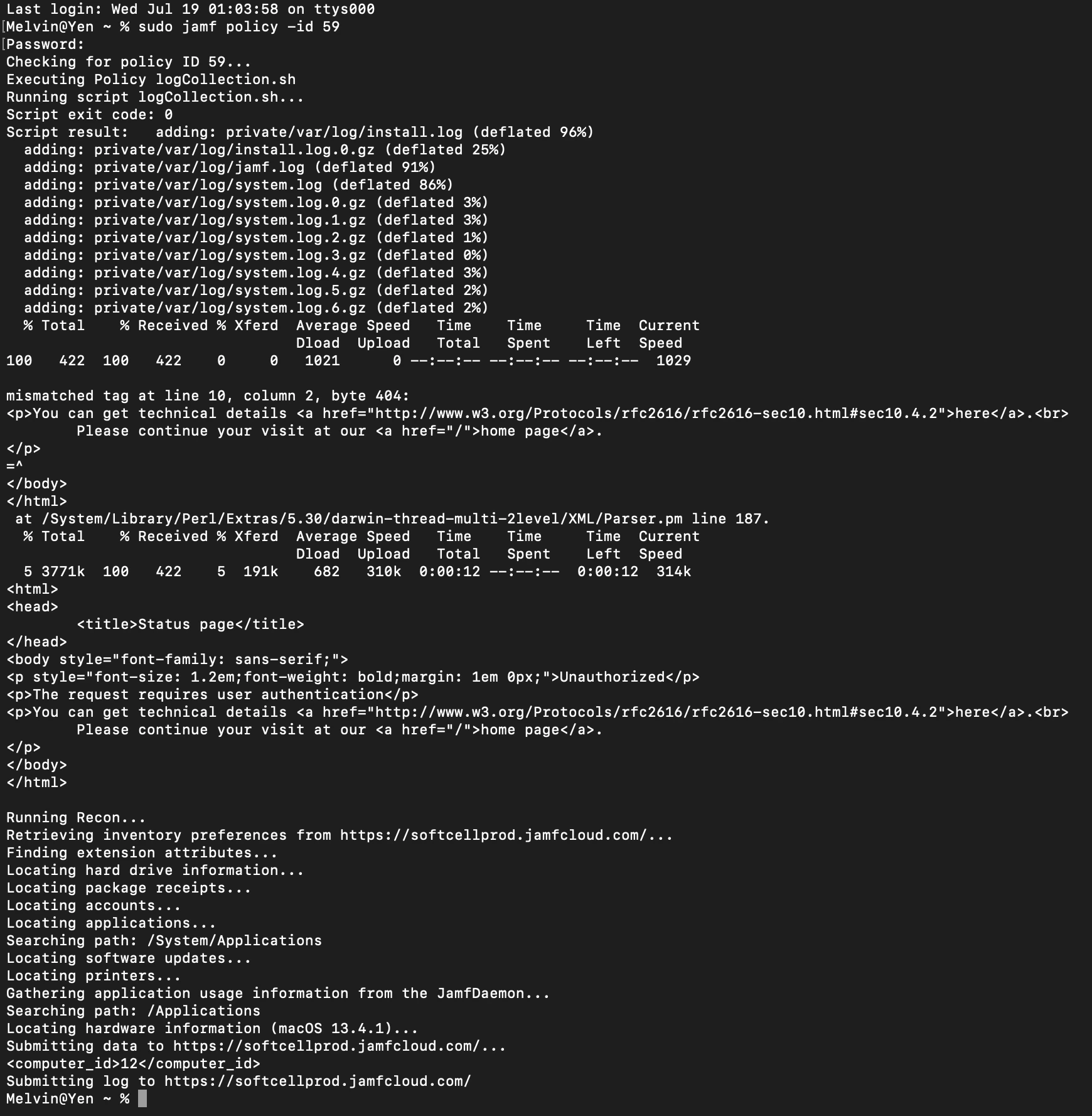

  • Jul 18, 2023 7:43 PM UTC
Dear @sdagley,
I am getting the above error while running the script as a Jamf policy.
Can you help me in this please?
sdagley
  • Jul 18, 2023 8:08 PM UTC
Dear @sdagley,
@melvinp At first glance it looks like the script is failing because it hasn't been converted to use Bearer Token instead of Basic authentication. Here's a guide on how to do that: https://community.jamf.com/t5/tech-thoughts/how-to-convert-classic-api-scripts-to-use-bearer-token/ba-p/273910
  • Jul 18, 2023 8:27 PM UTC
Hey @sdagley
How do we do this like should I run a Jamf policy. Can you tell me the steps if possible?

## User Variables
jamfProURL="$4"
jamfProUser="$5"
jamfProPass="$6"
logFiles="$7"
## System Variables
mySerial=$(system_profiler SPHardwareDataType | awk '/Serial Number/{print $4}')
currentUser=$(stat -f%Su /dev/console)
compHostName=$(scutil --get LocalHostName)
timeStamp=$(date '+%Y-%m-%d-%H-%M-%S')
## Debugging Outputs (Optional)
echo "Jamf Pro URL: $jamfProURL"
echo "Jamf Pro User: $jamfProUser"
# Do not echo the password for security
echo "Log Files: $logFiles"
echo "Serial Number: $mySerial"
echo "Current User: $currentUser"
echo "Computer Hostname: $compHostName"
## Log Collection
fileName="$compHostName-$currentUser-$timeStamp.zip"
echo "Creating zip file: /private/tmp/$fileName"
zip -r /private/tmp/"$fileName" $logFiles
## Obtain API Auth Token
authResponse=$(curl -sku "$jamfProUser:$jamfProPass" -X POST "$jamfProURL/api/v1/auth/token")
apiAuthToken=$(echo "$authResponse" | plutil -extract token raw -)
tokenExpiration=$(echo "$authResponse" | plutil -extract expires raw -)
if [ -z "$apiAuthToken" ]; then
echo "Failed to obtain API authentication token."
echo "Response: $authResponse"
exit 1
echo "API Authentication Token obtained. Token expires: $tokenExpiration"
## Corrected Filter Field for Serial Number
encodedSerial=$(printf '%s' "$mySerial" | python3 -c 'import sys, urllib.parse; print(urllib.parse.quote(sys.stdin.read().strip()))')
filterQuery="hardware.serialNumber%3D%3D$encodedSerial"
## Get Jamf Pro Computer ID using the Jamf Pro API
computerIDResponse=$(curl -sk --header "Authorization: Bearer $apiAuthToken" \\
"$jamfProURL/api/v1/computers-inventory?filter=$filterQuery")
jamfProID=$(echo "$computerIDResponse" | python3 -c "
import sys, json
data = json.load(sys.stdin)
if data['totalCount'] > 0:
print(data['results'][0]['id'])
else:
sys.exit(1)
" 2>/dev/null)
if [ -z "$jamfProID" ]; then
echo "Failed to retrieve Jamf Pro Computer ID."
echo "Response: $computerIDResponse"
exit 1
echo "Jamf Pro Computer ID: $jamfProID"
## Upload Log File
uploadResponse=$(curl -sk --header "Authorization: Bearer $apiAuthToken" \\
-X POST "$jamfProURL/api/v1/computers-inventory/$jamfProID/attachments" \\
-F "file=@/private/tmp/$fileName")
echo "Upload Response: $uploadResponse"
## Check for successful upload
if [[ "$uploadResponse" == *"id"* ]]; then
echo "Log file uploaded successfully."
else
echo "Failed to upload log file."
exit 1
## Invalidate API Auth Token
curl -sk --header "Authorization: Bearer $apiAuthToken" "$jamfProURL/api/v1/auth/invalidate-token" -X POST
## Cleanup
rm /private/tmp/"$fileName"

I know this is digging up an old post, but here's a new script that uses API to do the same thing:
## User Variables
jamfProURL="$4"
jamfProUser="$5"
jamfProPass="$6"
logFiles="$7"
## System Variables
## Log Collection
exit 1
import sys, json
else:
sys.exit(1)
" 2>/dev/null)
exit 1
## Upload Log File
else
exit 1
## Cleanup
Nice find. It was working for me at first so I had to modify the curl address commands to a single line by removing the breaks. Now it works nicely.
#!/bin/bash ## User Variables jamfProURL="$4" jamfProUser="$5" jamfProPass="$6" logFiles="$7" ## System Variables mySerial=$(system_profiler SPHardwareDataType | awk '/Serial Number/{print $4}') currentUser=$(stat -f%Su /dev/console) compHostName=$(scutil --get LocalHostName) timeStamp=$(date '+%Y-%m-%d-%H-%M-%S') ## Debugging Outputs (Optional) echo "Jamf Pro URL: $jamfProURL" echo "Jamf Pro User: $jamfProUser" # Do not echo the password for security echo "Log Files: $logFiles" echo "Serial Number: $mySerial" echo "Current User: $currentUser" echo "Computer Hostname: $compHostName" ## Log Collection fileName="$compHostName-$currentUser-$timeStamp.zip" echo "Creating zip file: /private/tmp/$fileName" zip -r /private/tmp/"$fileName" $logFiles ## Obtain API Auth Token authResponse=$(curl -sku "$jamfProUser:$jamfProPass" -X POST "$jamfProURL/api/v1/auth/token") apiAuthToken=$(echo "$authResponse" | plutil -extract token raw -) tokenExpiration=$(echo "$authResponse" | plutil -extract expires raw -) if [ -z "$apiAuthToken" ]; then echo "Failed to obtain API authentication token." echo "Response: $authResponse" exit 1 fi echo "API Authentication Token obtained. Token expires: $tokenExpiration" ## Corrected Filter Field for Serial Number encodedSerial=$(printf '%s' "$mySerial" | python3 -c 'import sys, urllib.parse; print(urllib.parse.quote(sys.stdin.read().strip()))') filterQuery="hardware.serialNumber%3D%3D$encodedSerial" ## Get Jamf Pro Computer ID using the Jamf Pro API computerIDResponse=$(curl -sk --header "Authorization: Bearer $apiAuthToken" "$jamfProURL/api/v1/computers-inventory?filter=$filterQuery") jamfProID=$(echo "$computerIDResponse" | python3 -c " import sys, json data = json.load(sys.stdin) if data['totalCount'] > 0: print(data['results'][0]['id']) else: sys.exit(1) " 2>/dev/null) if [ -z "$jamfProID" ]; then echo "Failed to retrieve Jamf Pro Computer ID." echo "Response: $computerIDResponse" exit 1 fi echo "Jamf Pro Computer ID: $jamfProID" ## Upload Log File uploadResponse=$(curl -sk --header "Authorization: Bearer $apiAuthToken" -X POST "$jamfProURL/api/v1/computers-inventory/$jamfProID/attachments" -F file=@/private/tmp/$fileName) echo "Upload Response: $uploadResponse" ## Check for successful upload if [[ "$uploadResponse" == *"id"* ]]; then echo "Log file uploaded successfully." else echo "Failed to upload log file." exit 1 fi ## Invalidate API Auth Token curl -sk --header "Authorization: Bearer $apiAuthToken" "$jamfProURL/api/v1/auth/invalidate-token" -X POST ## Cleanup rm /private/tmp/"$fileName" exit 0
  • Oct 23, 2024 3:44 PM UTC
*wasn't working -- now it does with my modifications.
tdenton
  • Dec 10, 2024 11:10 AM UTC
@david_maestre  scripts above seems to work fine but getting a error related to not having xcode installed.
xcode-select: error:
no developer tools were found at '/Applications/Xcode.app', and no install could be requested (perhaps no UI is present), please install manually from 'developer.apple.com'. Failed to retrieve Jamf Pro Computer ID.
Is there anywhere this script can be run without having xcode installed, I couldnt see any reference to it in the script.My scripting isnt up to much though.
