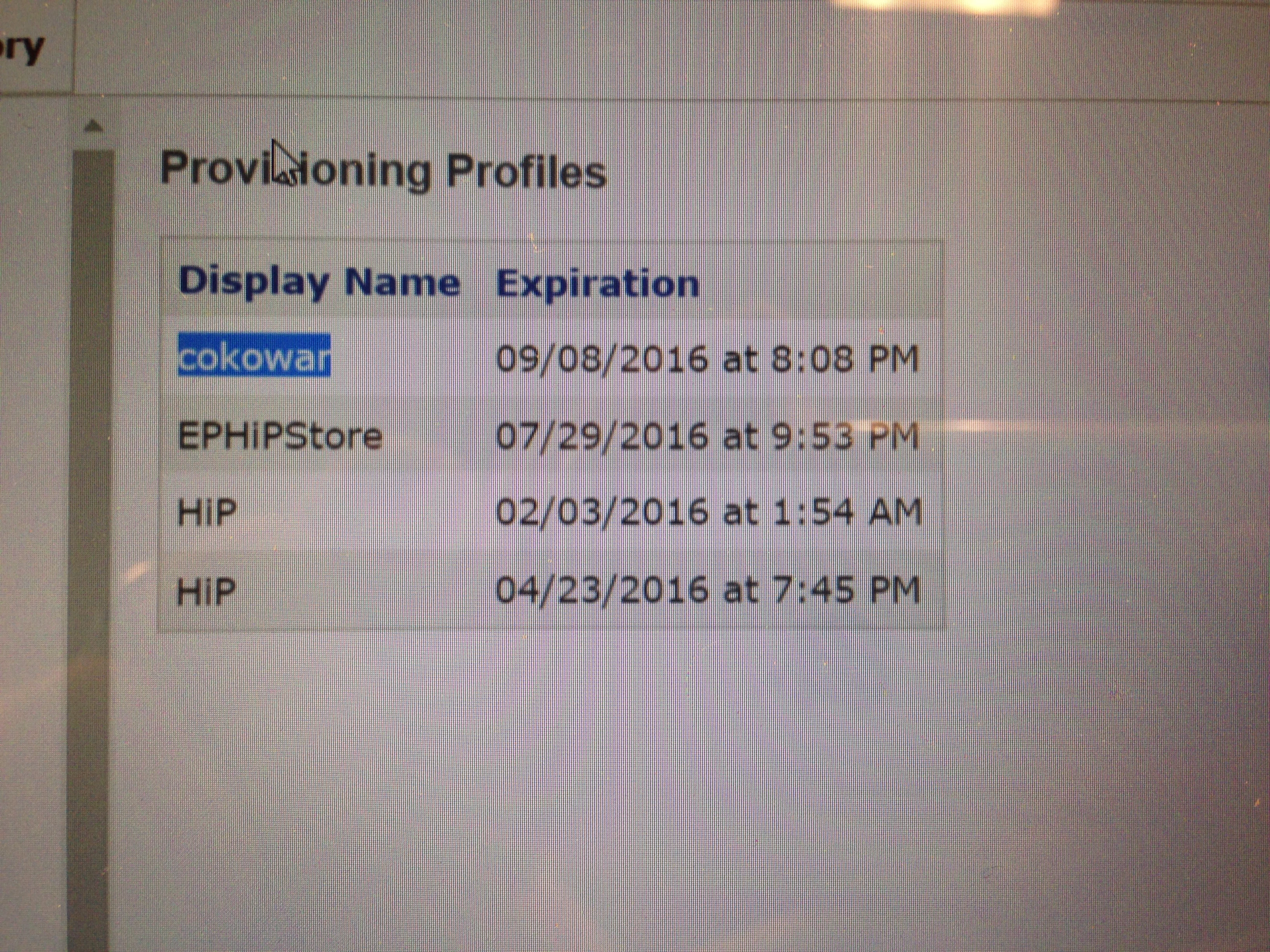

I have tried unchecking 'Allow trusting new enterprise app authors' and was still able to download vShare, which installed a Provisioning Profile. I was not prompted to accept a profile or trust anything, with or without the configuration, just pressed Install. I'm wondering how this feature is supposed to work?
I have verified that the key is correct in the Configuration Profile.
<key>allowEnterpriseAppTrust</key><false/>
JSS 9.80
iOS 9.0.1
cdenesha
  • October 13, 2015
Ok I have it now.. after finding a good article that explains it.
I actually have to launch the side-loaded app, which tells me that I need to trust it, then I need to manually go to Settings -> Profiles and Trust. With the restriction in place, there is no option to trust. Yay!
I'll still be notified that they tried, as the original app download installs its own Provisioning Profile, which seems to stay there even if vShare (in my case) is deleted. Then the student will be called down to the office.
