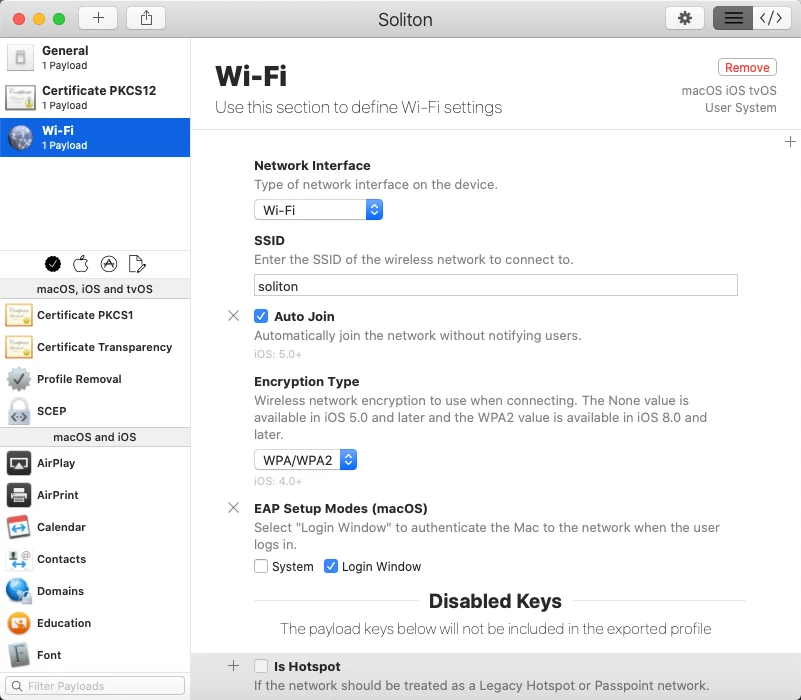

Yes, Jamf is an MDM provider. Depending on how many Apple devices you have you can either look at Jamf Pro or Jamf Now. If you're in the education sector they also have Jamf School. Go to their main website and fill out a contact form if you're interested in any of them.
In Profile Creator you're looking for EAP Setup Modes in the Wifi Payload section. Also ensure the certificate is in the same profile otherwise it won't work.
  • September 24, 2021
Yes , we will deploy jamf once we are ready .
Do you mean select "Login Window" like below ?
I've tried , but networkA will still be disconnected under Login Window ..

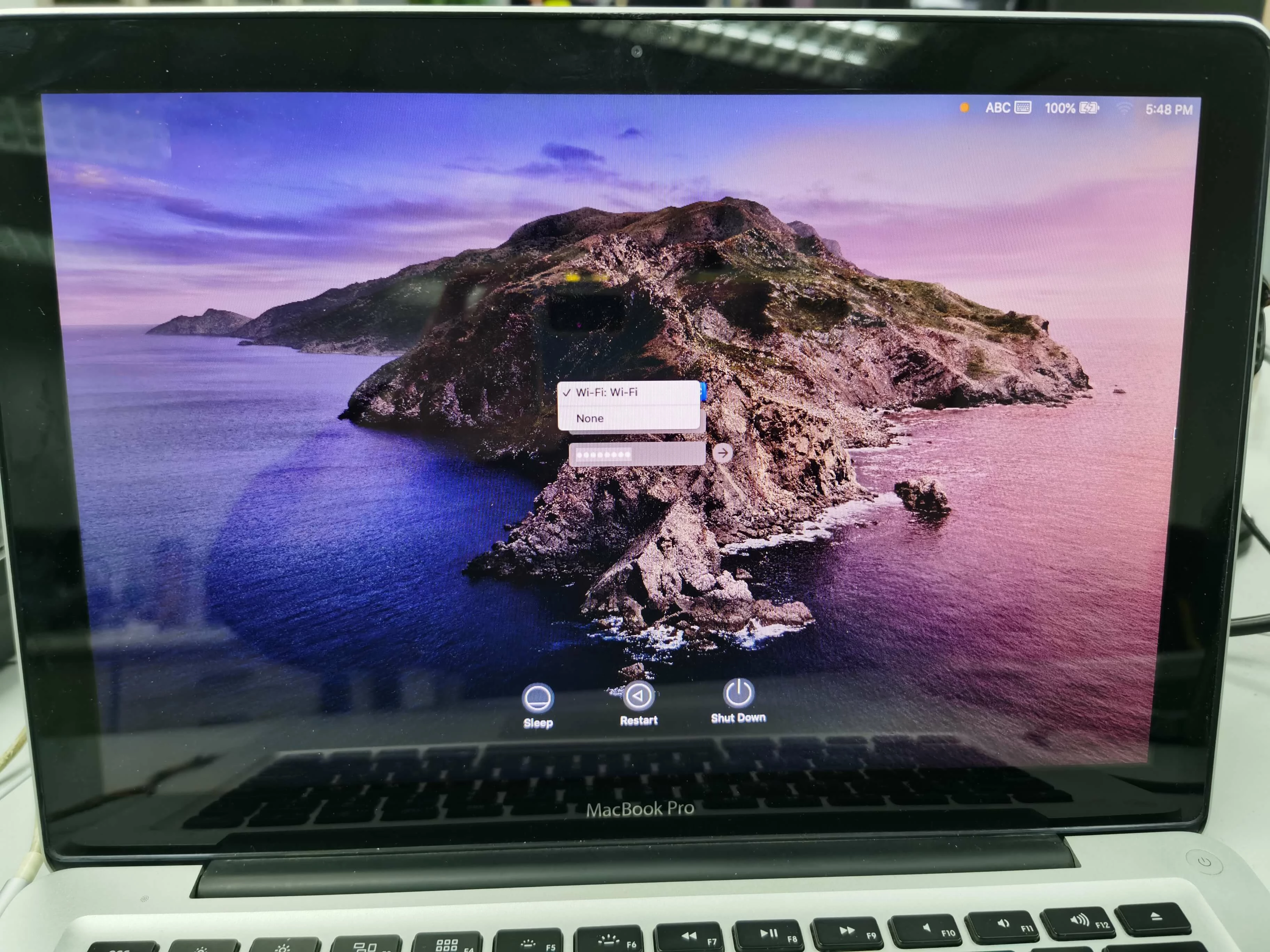

@mainelysteve
I've installed the profile .
I'm going to authenticate the wi-fi at login screen,but i can't find the correct SSID in the pull-down menu..
  • November 29, 2021
@mainelysteve

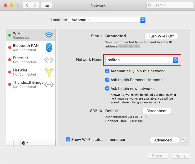

If you login using a local admin account do you see the network in your preferred networks list in System Preferences > Network > Wifi ?
Double check the ssid and the encryption type.
  • December 1, 2021
Yes , i can see the network in Wifi panel .
The encryption type was set to WPA2 .
  • December 1, 2021
Then it most likely can't connect without a user logged in. Check that the certificate is loaded into the system keychain and not anywhere else i.e. login keychain.
