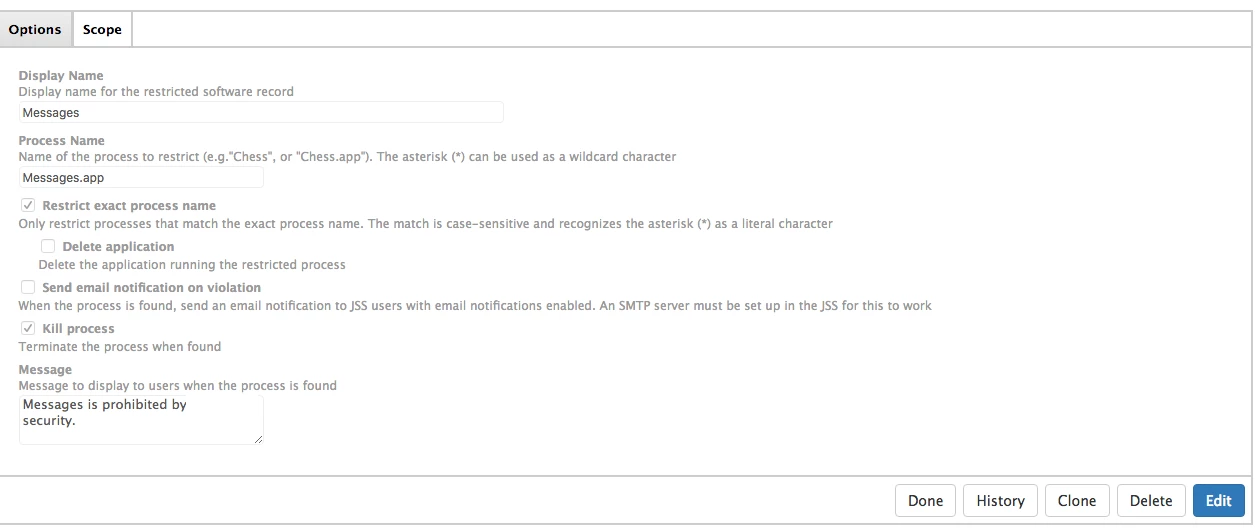

@CJeffery This is what we have for Messages and haven't had any issues.
