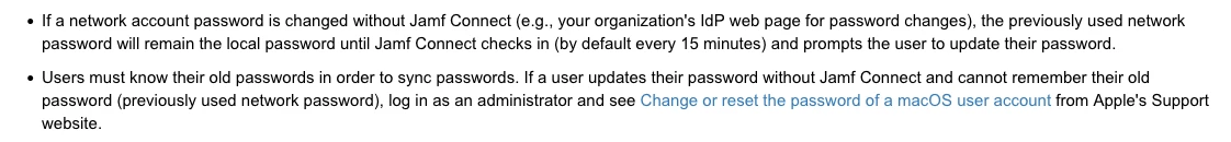

From the manual I understand this:
But our problem is the user is not receiving any information if the passwords are out of sync!

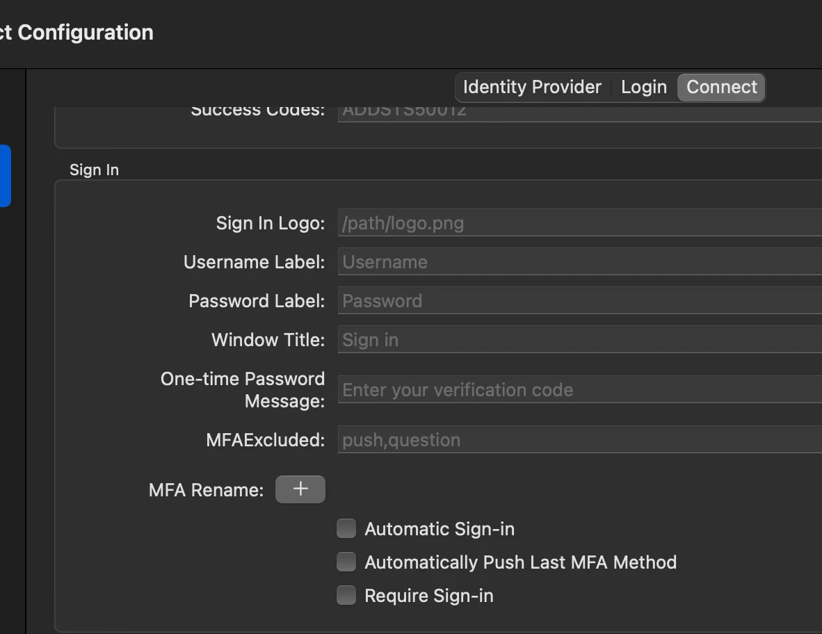

Also, when you made your config in Jamf Connect Configuration, did you check the "Automatic Sign-in" box under the Connect tab? If you don't check that, then you'll need to manually select Connect from the menu bar applet after logging in.
Where can I find the checkbox for "Automatic Sign-in" box. Thank you, but I think it's connected because the login credentials are filled and grayed out, when clicking on connect.
  • 37 replies
  • November 3, 2021
44r3n wrote:
@mjhershthank you for your reply.
It's in the Connect tab of the Jamf Connect Configuration app. See attached screenshot. Though if you're manually selecting Connect from the menu and it still isn't prompting you to synchronize passwords, there's probably a different problem.
