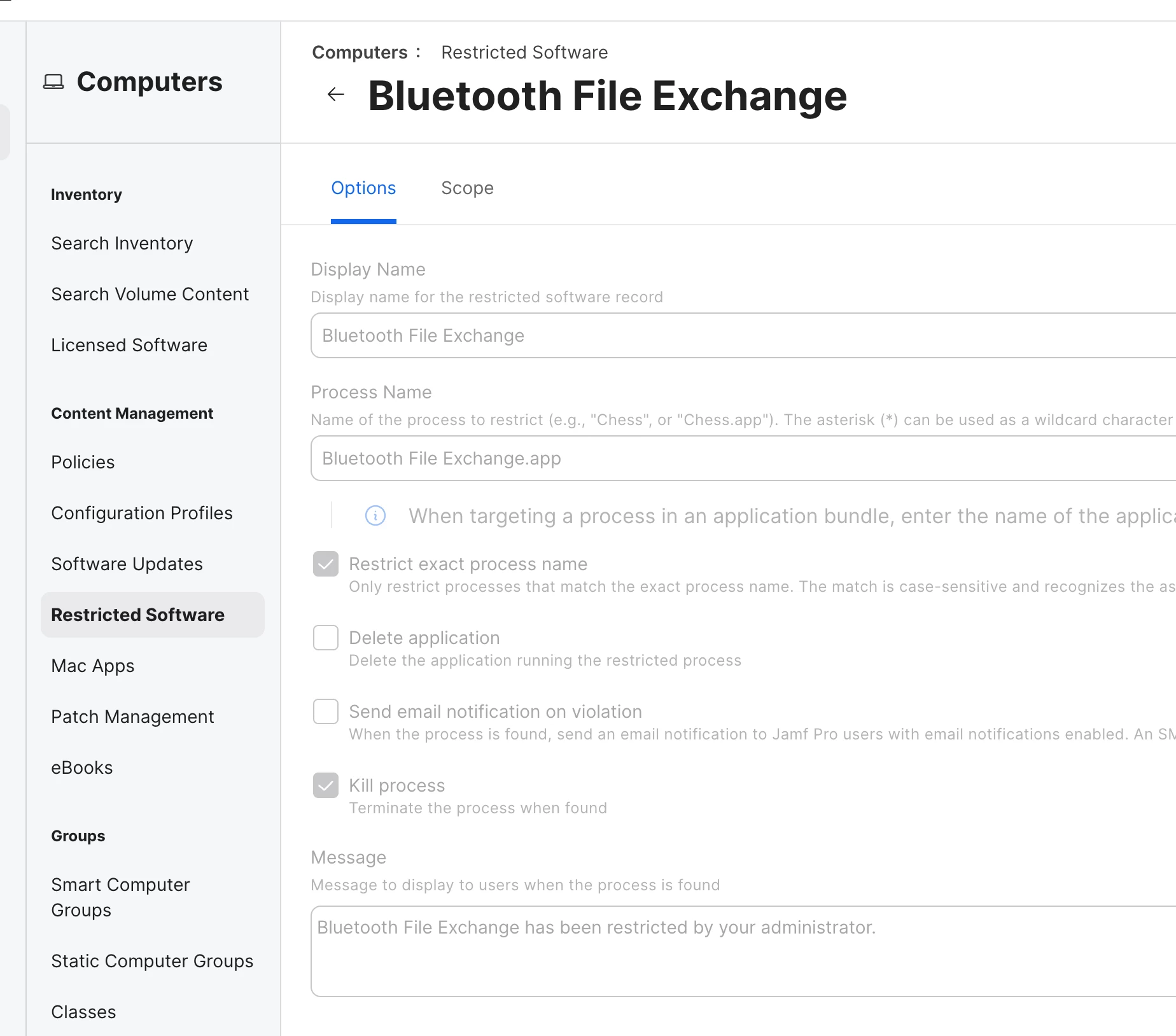

It should be with a Restricted Software entry killing the process name.
Thanks, figured it out right after i posted, thanks for replying though!
This worked for me too! Just in case the image goes down, the solution is just to enter "Bluetooth File Exchange.app" (no quotes, no need to escape the space) in the Jamf > Computers > Restricted Software > (pick or make a policy) > Process Name field. Also check the "Kill process" box. They have "Restrict exact process name" checked in the photo, but mine also works without that box checked. Either's fine, I guess.

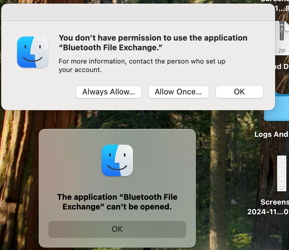

Solution for this, actually: do the first paragraph, but instead type "/System/Applications/Utilities/Bluetooth File Exchange". Apparently .app files count as directories and so this will prevent the launching of Bluetooth File Exchange, but still allow other apps within /System/Applications/Utilities to launch.

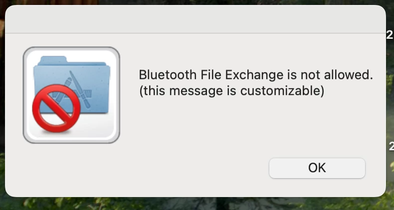

Do note, this method causes the following "blocked" message to appear when Bluetooth File Exchange is launched:
while easyedc's method above makes this "blocked" message appear:
Personally, I prefer the second "blocked" message, because the first makes it sound like IT will allow Bluetooth File Sharing if they ask. Which we won't, and I don't want them to email me about it.
