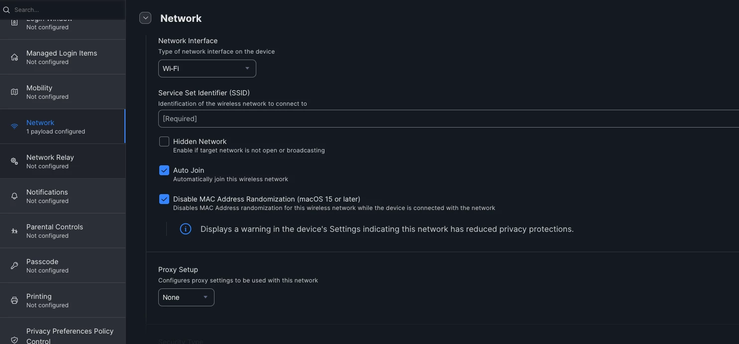

@AJPinto You are correct, in Jamf Pro 11.9.1 the "Disable MAC Address Randomization (macOS 15 or later)" option is part of the Network payload in a Configuration Profile and only applies to the SSID being configured in that Network payload.

I may have resolved my issue.  The configuration profile with the 'Disable MAC Address Randomization (macOS 15 or later)' setting enabled is needed prior to the upgrade.  If you rely solely on the plist modification, the "evaluation" will still happen.  If you have the profile in place, it seems to obey the setting in the plist file upon upgrade to Sequoia.  I was testing in my production environment where we haven't updated our Wi-Fi config profile yet.  My test environment has it and this workflow seems to work as designed.

I also turned off Private Mac addresses in Jamf configuration policy.
